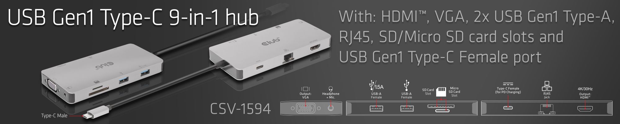

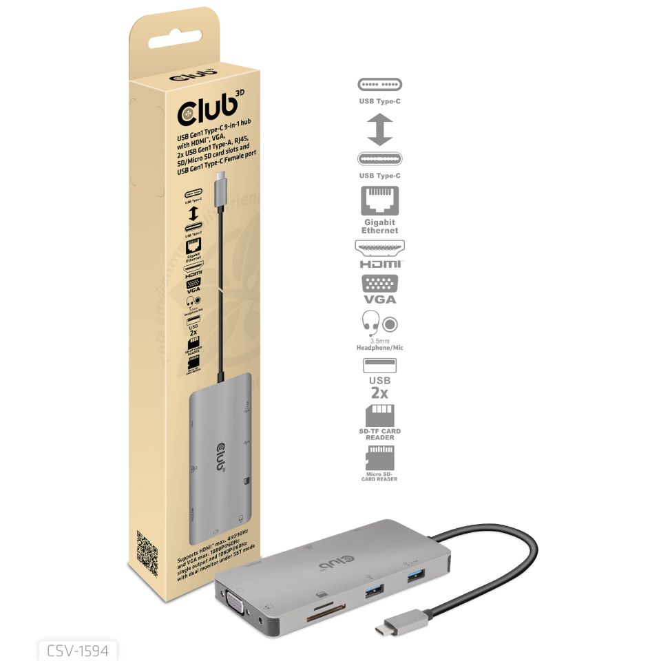

The Club 3D CSV-1594 USB Gen1 Type-C 9-in-1 hub with HDMI™, VGA, 2x USB Gen1 Type-A, RJ45, SD/Micro SD card slots and USB Gen1 Type-C Female port, provides a very advanced, efficient solution to extend a single USB Gen1 Type-C port to be multiple ports. It integrates video, data and power ports that allows to connect 2 displays simultaneously for enjoying videos on a larger screen, connect multiple  USB Gen1 devices for data transmission up to 5Gbps, connect a Gigabit Ethernet source for getting your PC connected to super high speed network, or connect to headset to enjoy fantastic music. It also provides PD charging for support up to max. 100W PD charging. This is for operating this device and charge the host simultaneously. It can work on all DP™1.2 Alt mode supported  USB Gen1 Type-C hosts.

• 1x USB Gen1Type-C Male(Connect to host) Support DP™1.2 Alt mode
Note: To get max bandwidth, the host should support DP™1.2 Alt mode
Output(s):
• 1x HDMI™
Support max [email protected]
Support 8/10 bit color depth output
Support output pixel format RGB/YCbCr4:4:4/YCbCr4:2:2
Support HDCP1.4
• 1x VGA
Support max [email protected] output
Support to output 2 video under SST mode with dual [email protected]
Note: The max resolution of the display determined by the computer and the monitor
• 2x USB Gen1 Type-A
Max 5Gbps data transmission per port
Support max 7.5W(5V/1.5A) downstream charging the other port supports max, 900mA downstream charging.
2 USB Gen1 Type-A ports share max 1.8A output
Support short-circuit, over-current, over-voltage protection
• 1x RJ45
Support Gigabit Ethernet,10M/100M/1000M
Support Wake-On-LAN
Support full duplex flow control
Support to work with Nintendo Switch™
Light indicator indicates the state, no light when no Internet connected, orange light turns on when network connection is established, green light flashes when transmitting data
• 2x SD/Micro SD 3.0
Support SD3.0 UHS-I up to 104MBps data rate
Allow 2 card slots to work simultaneously
• 1x 3.5mm Audio jack
Support Phone out with digital audio max 96KHz/24bit sampling rate
Support Mic in with digital audio max 96KHz/24bit sampling rate
DAC SNR MAX 95 dB
Support CTIA&OMTP auto detection
Support voice adjustment function when connected to headset
• 1x USB Gen1 Type-C Female (for PD Charging)
Support max 100W PD charging
Support PD3.0 Fast Role Swap, the connected device will not get disconnected while plugging in and out the PD Adapter
15W is dedicated to the functioning of this product, the rest power (max 85W) will be passed to charge for the host
• All
• 1x USB Gen1 Type-C 9-in-1 hub with HDMI™, VGA, 2x USB Gen1 Type-A, RJ45, SD/Micro SD card slots and USB Gen1 Type-C Female port
• 1x Quick Install Guide(QIG)
• USB Gen1 Type-C Male
(Connect to host)
• 1x HDMI™ Female
• 1x VGA Female
• 2x USB Gen1 Type-A Female
• 1x RJ45
• 1x SD/Micro SD 3.0
• 1x 3.5mm jack Audio
