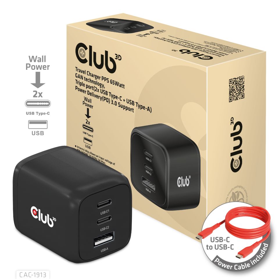

The Club3D CAC-1913 Travel Charger PPS 65Watt GAN technology, Triple port(2x USB Type-C + USB Type-A) Power Delivery(PD) 3.0 Support. GAN technology chipset makes this charger 50% smaller than a 65Watt traditional charger, small enough to carry anywhere.The Programmable Power Supply(PPS) 65Watt wall charger match a variety of PD devices from smart phones to laptops, one for all making charging simple. This wide compatibility charger will be your convenient companion during your business trip or vacation.
The Power Charger is light weight without compromising on Quality and safety. By adopting Power Delivery(PD) charging technology, this versatile Power Charger provides you with charging functions through Dual USB Type-C plus a USB Type-A interface, you can charge any connected Mobilephone / Tablet / NoteBook. Furthermore all it needs is a free USB Type-C port on your Dock/NoteBook/Tablet/ Mobile phone to be charged via the bundled USB Type-C cable.

Single Port Output : |
USB-C1 or USB-C2: |
• PD 5V/9V/12V/15V⎓3A,20V⎓3.25A |
• PPS: 3.3-20V⎓3.0A Total: 60W Max. |
USB-A: |
4.5V/5A,5V/4.5A,9V/3A,12V/2.5 A,20V/1.5A Total: 30W Max. |
2-Port Output USB-C1+USB-C2: |
USB-C1: 5V/9V/12V/15V⎓3A,20V⎓3.25A |
PPS3.3-16V/3A) 45W Max. |
USB-C2: 5V/3A,9V/2.2A,12V/1.67A |
PPS: 3.3-11V/2A 20W Max. |
Total 65W Max. |
2-Port Output USB-C1+USB-A: |
PPS: 3.3-16V/3A 45W |
USB-A: 5V/3A,9V/2A,12V/1.5A(QC3.0 3.6-12V/1.5A) 18W |
Total 63W Max. |
2-Port Output USB-C2+USB-A: |
USB-C2: 5V/1.5A |
USB-A: 5V/1.5A |
Total 15W Max. |
3-Port Output USB-C1+USB-C2+USB-A |
USB-C1: 5V/9V/12V/15V⎓3A,20V⎓2.25A |
PPS 3.3-16V/3A 45W |
USB-C2+USB-A: 5V/3A 15W |
Total 60W Max. |
