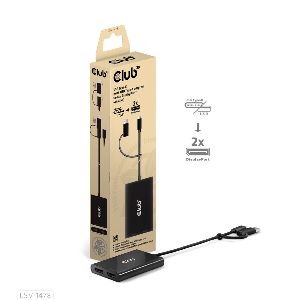

USB Type-C (with USB Type-A adapter) to dual DisplayPort™(4K60Hz) Video Splitter
The Club 3D CSV-1478 USB Type-C (with USB-A adapter) to dual DisplayPort™ (4K60Hz) Video Splitter with DisplayLink® which provides most advanced, efficient solution. It supports max. single 4K60Hz or dual 4K60Hz simultaneous output of different videos(Extened Desktop). It can work on USB Mode and DP™ Alt mode supported USB Type-C and USB Type-A hosts.
Product Name: USB Type-C (with USB Type-A adapter) to dual DisplayPort™(4K60Hz) Video Splitter |
Product Series: Video Splitter |
Product Code: CSV-1478 |
EAN code: 8719214472993 |
UPC code: 841615103256 |
• Support DisplayLink® |
• Support DisplayPort™max. 4K60Hz per port |
• Support to output dual 4K60Hz simultaneously with different pictures(Extended Desktop) on both USB Type-C and USB Type-A hosts |
• Support outputting different pictures on both Windows and Apple including M1 and M2 silicon |
• Windows 10 or upwards, Mac OS 14.2.1 |
• 1X CSV-1478 USB Type-C (with USB Type-A adapter) to dual DisplayPort™ (4K60Hz) Video Splitter |
Available Interfaces |
• 1x USB Type-C (with USB Type-A Adapter) Male(Connect to host) |
• 2x DisplayPort™ Female |
• Box size: 8 x 25 x 3.5 cm / 3.15 x 9.84 x 1.38" |
• Device size: 9 x 6.1 x 1.4 cm / 3.54 x 2.4 x 0.55" |
• Input Cable length approx.: 18.5 cm / 7.29" |
• Connector dimensions: |
-USB Type-A(Adapter): 3.1 x 1.6 x 0.9 cm / 1.22 x 0.63 x 0.35" |
-USB Type-C: 2.5 x 1.2 x 0.7 cm / 0.98 x 0.47 x 0.28" |
• Device Weight: 95 gr / 3.35 oz |
• Box Weight: 32 gr / 1.13 oz |
• Bio Degradable Bag size: 9 x 30 cm / 3.54 x 11.81" |
• Bio Degradable Bag Weight: 1 gr./ 0.04 oz |
• Total Weight: 128 gr / 4.52 oz |
- Club 3D uses environmentally friendly packaging and is printed on recycled paper. |
- Club 3D uses Bio-Degradable bags according to the EN/DIN 13432 |
Warning Safe Usage - Product Only to be used at altitude 2000 meters/6562 feet and below |
