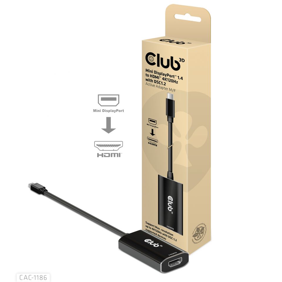

The Club 3D CAC-1186 is the perfect solution to connect to any HDMI™ 8K60Hz* or 4K120Hz* ready display. When you have a  PC with a Mini DisplayPort™ 1.4 connection or any other device that lacks the new HDMI™ 8K60Hz* or 4K120Hz  specification, the Club3D CAC-1186 will be the simple way to upgrade your device and connect to your new TV*. With its DP™1.4 DSC1.2 video compression technology, this adapter is able to convert DP™1.4 video signals to HDMI™ , supporting video display resolutions up to 8K(7680*4320)@60Hz **  or 4K (3840 x 2160)@120Hz ** and creating life like colors and movements with HDR10 giving users the ultimate visual experience. The Adapter is powered thru the Mini DisplayPort™ connection.

Mini DisplayPort™ 1.4 to HDMI™ 4K120Hz with DSC1.2 Active Adapter M/F
Product Series: Adapter
Product Code: CAC-1186
EAN code: 8719214471989
UPC code: 841615102211
• Compliant with VESA DisplayPort™ v1.4 Specification
• Compliant with HDMI™ 4K120Hz Specification
• Support HDCP 2.2
• Support DSC v1.2a and backward compatible with the former version
• Support Max. resolution/refresh rates up to [email protected]
• Support Dynamic HDR10
• No External Power needed(Powered thru the Mini-DisplayPort™ connection)

• CAC-1186 Active Adapter
• Mini-DisplayPort™ Male
• 1x HDMI™ (Female)
Note: HDMI™ Cable should meet 8K30Hz specs(or above) and should not exceed 2 m / 6.56 ft
• Box size: 6 x 24 x 3.5cm / 2.36 x 9.45 x 1.38"
• Device size: 3.15 x 6 x 1.4cm / 1.24 x 2.36 x 0.55"
• Cable length approx.: 15 cm / 5.9"
• Total length approx.: 21 cm / 8.27"
• Connector dimensions:
- Mini DP Male: 0.92 x 1.1 x 2.35cm / 0.36 x 0.43 x 0.93"
• Device Weight: 36 gr / 1.27oz
• Box Weight: 28 gr / 0.99 oz
• LDPE Bag Weight: 5 gr / 0.18 oz
• Total Weight: 69 gr / 2.43 oz
This product is SPECIFICALLY designed to work with the latest Graphics Processing Units (GPU’s) which supports DP1.4™ with DSC 1.2.
Please make absolutely sure that you’re using one the above mentioned graphical technologies in order to obtain the Superior functionality of our Club 3D CAC-1186.
This adapter will function with lower specifications GPU’s, be aware performance will be reduced due to the specifications of that GPU !! Functionality is also dependent on the HDMI™ M/M cable used.
In combination with this CAC-1186 adapter we advise to use HDMI™ Male/Male cable of 28AWG Quality or above, like the Club 3D CAC-1370, CAC-1371 and/or CAC-1372 up to 2m/ 6.56 ft max. !
