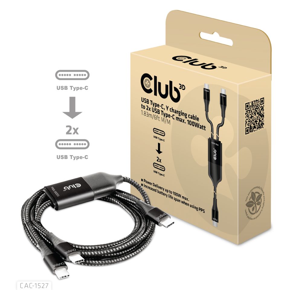

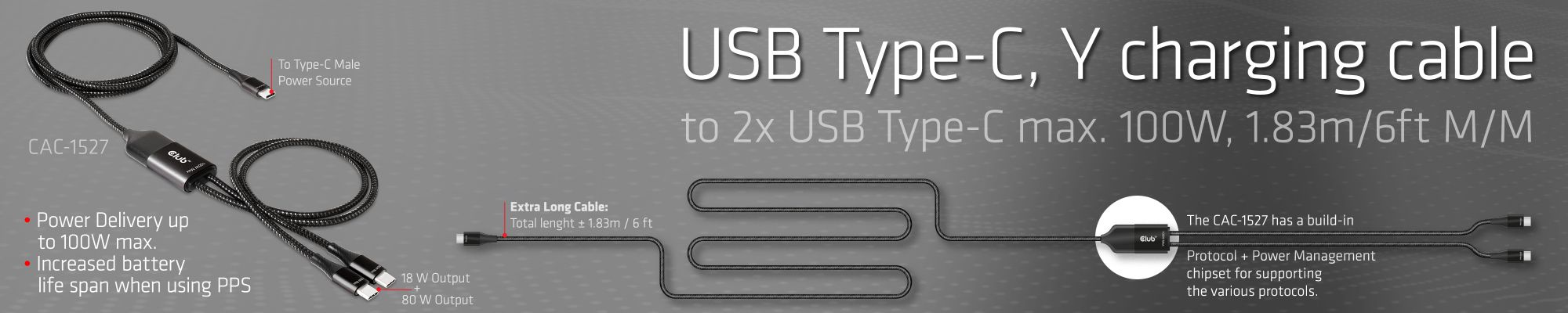

USB Type-C, Y charging cable to 2x USB Type-C max. 100W, 1.83m/6ft M/M
This Club 3D CAC-1527 USB Type-C cable is a powerful cable which enables you to fast charge two Type-C devices simultaneously. When one device is connected, the power delivery will be max 100W with PPS support. When two devices are connected, max 98W in total with NO PPS support ! The CAC-1527 has a build-in Protocol + Power Management chipset for supporting the various protocols. Because of the PPS protocol your batteries will be charged in such a manner that it will increase the life span of your battery.PPS is ONLY supported when 1 device is connected!

Available Interfaces |
• USB Type-C male, marked Source |
• 1x USB Type-C male, marked 18W Max. |
• 1x USB Type-C male, marked 80W Max. |
• Box size: 10 x 10 x 3.5 cm/ 3.94 x 3.94 x 1.38" |
• Device size: 6.25 cm / 0.21 inch |
• Total Cable length approx.: 1.83 m / 6 ft |
