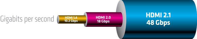

HDMI 2.0 AKA Premium High Speed - Increases bandwidth to 18 Gbps ( 594Mhz ) the increases comes from the maximum throughput from 3.4 Gbps to 6 Gbps . 2.0a added support for High Dynamic Range ( HDR ) video with static metadata. and 2.0b which extends support for HDR.
HDMI 2.1 AKA Ultra High Speed, announced on January 2017, adds support for Dynamic HDR which is dynamic metadata that allows for changes on a scene by scene or frame by frame basis. Also added suportfor eARC. Increases bandwidth to 48 Gbps, The increase of bandwidth is achieved with a maximum throughput from 6 Gbps to 12 Gbps and from 3 lanes to 4 lanes, allowing for resolutions up to 4K120Hz or 8K60Hz.
Why HDMI 2.1 ?
Any digital interface is ultimately limited by bandwidth, or speed of the connection. In the case of HDMI 1.4 that upper boundary is the 330Mhz data rate per channel (for a total of 10.2Gb/s) at which the interface runs.
This maximum overall data rate of 10.2 Gigabits per second (Gb/s) with its maximum clock rate of 330Mhz is enough to transport Full HD (1920*1080 ) and Wide UXGA (1920*1080) Images. Support here is up to 1080p at 60Hz at 4:4:4 (RGB) or 2160p at 30Hz at 4:4:4 (RGB) 8bit only or 2160p at 60Hz at 4:2:0.
In order to accommodate faster refresh rates HDMI 2.0 was introduced with the overall data rate through the interface to 18 Gb/s and a clock rate of 594Mhz. This specification is able to transport up to 2160p at 60Hz at 4:4:4 (RGB) 8bit only and it supports HDR specifications. In addition HDMI 2.0 supports USB Type C Alt Mode.
HDMI 2.0b which is backwards compatible with earlier versions of HDMI specification is the most recent update of the HDMI specification. It also enables key enhancements to support market requirements for enhancing the consumer video and audio experience. The key advanced feature enabled by HDMI 2.0b is - it enables transmission of High Dynamic Range (HDR) video in the form of HLG (Hybrid Log Gamma)
The next generation HDMI 2.1 increases the overall data rate to 48Gb/s supporting resolutions of up to 4K120Hz or 8K60Hz and is able to additionally support up to 16 Bit colors and supports DSC (Display Stream Compression) for greater efficiency. This is called the Ultra HighSpeed Cable and can be checked by the apropriate HDMI Certification app.
